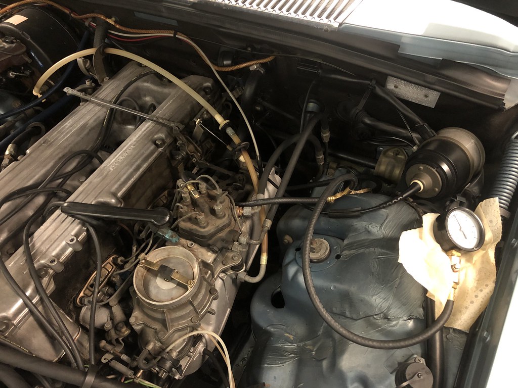

Did some more testing.
Looks like my cold control pressure is way too high
also looks like my fuel pump is on the way out as it gets very noisy after a while. Will replace that first.

I'm testing cold control pressure as my theory is my warm up regulator is the culprit.
engine has to be totally cold, and warm up regulator power disconnected to watch the readings change first when engine is cold and then as it heats up.

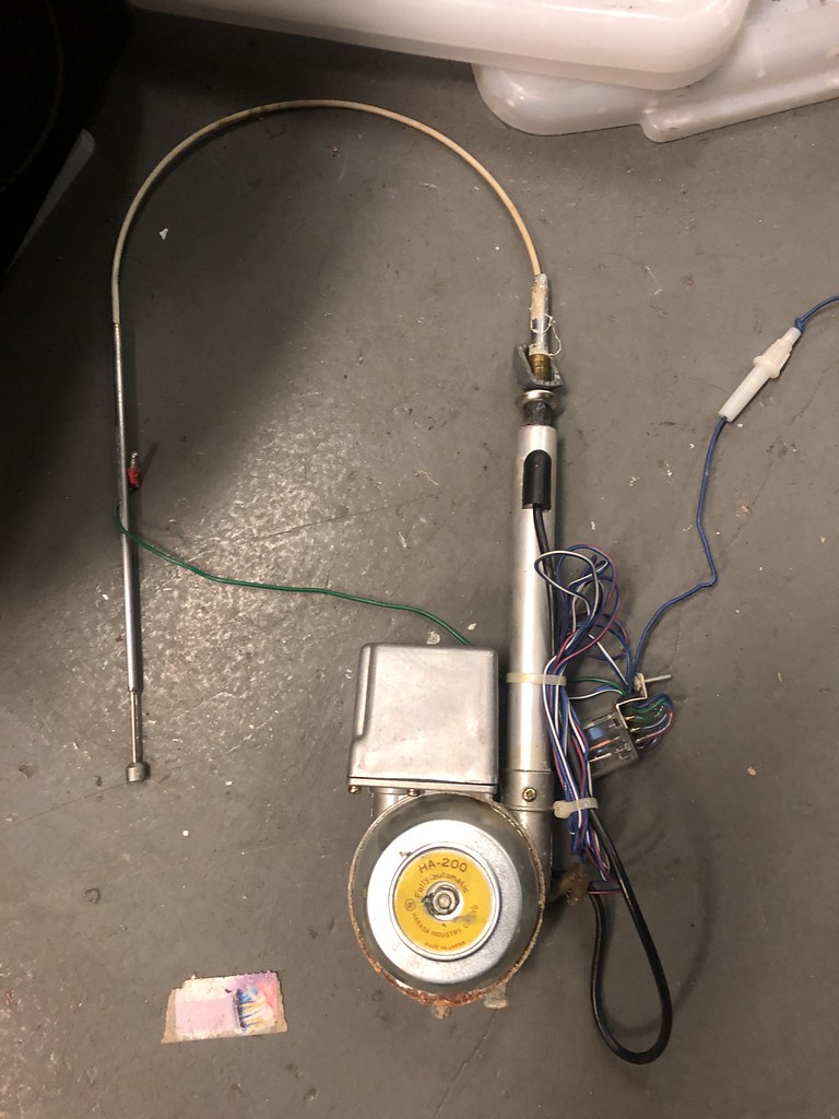

I’ve also removed the broken aftermarket antenna. I’ve mounted a new one but not wired it up yet. At least it looks neat now.

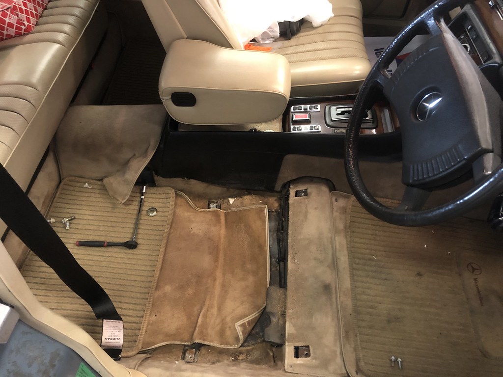

Next I have been cleaning the carpets. Carpets were in good shape but a little dirty. Doesn’t look like much improvement from the photos but they are better.
Before:
The car also had floor mats from another car that didn’t fit. I had some mats from my 560SEC that are a little worn but the right colour. Since the w126 is basically a second generation w116 I hope they fit. I gave them a good clean too. Certainly a lot of dirty water came out. 20870E34-AE37-461E-B726-508CE6BEB0EC.jpeg
On Saturday I need to give the car a good wash, install the mats, check tyre pressure put in a full tank of petrol and take it for a test drive.
it still needs an oil change, SLS rod, drag link, new tie rod end, drivers seat bottom repair and some other misc stuff.

Last night I wired up the antenna, reinstalled the carpets and floor mats, checked tyre pressures, changed all fuses, washed the car, refueld and took it on an extended test drive. Seems ready for the event.

Original becker works but the on/off doesn't seem to and since I can't turn it off, I can't lower the (new) antenna and park it under the hoist.

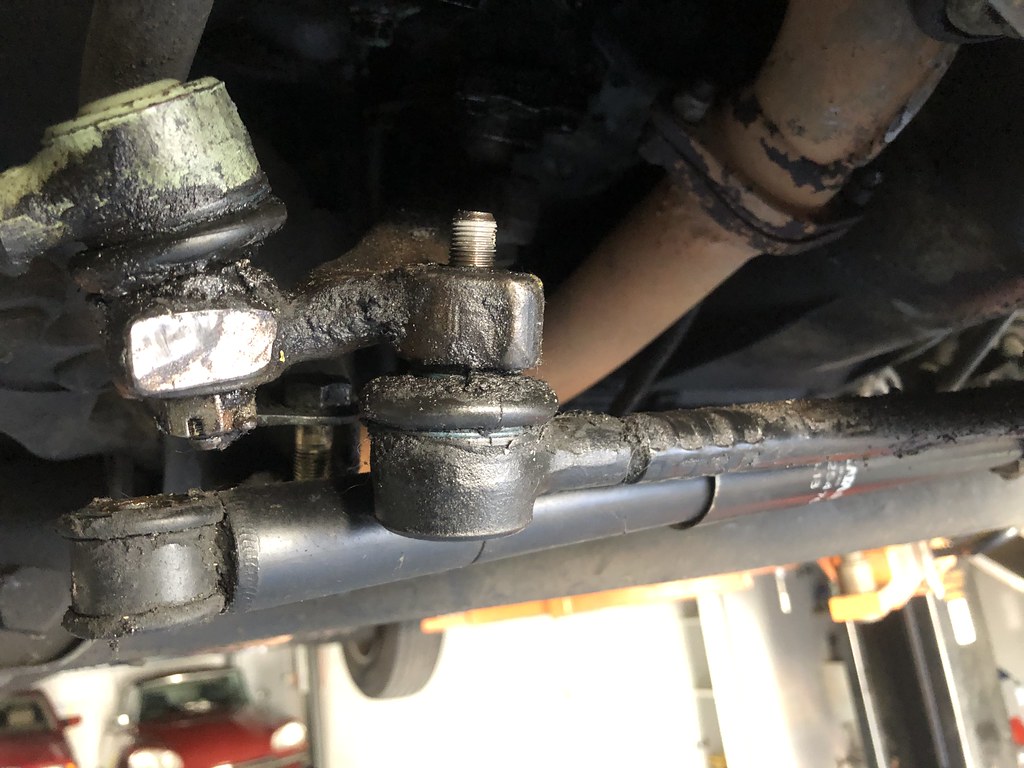

Did the drag link, idler arm and all four tie rod ends.
Idler arm looked a bit old and sorry, glad i did it, it was pretty bad when it came out.
Only one tie rod really needed doing, but its not that big a deal to do both sides while I am there, and since I have to pay for an alignment, rather do that once.
Helps to have the right tool. trying to do this without the ball joint separator is a huge pain and it wasn't even very expensive. Bought it a few years ago when I was helping my brother do the 280CE tie rod ends that failed his rego.

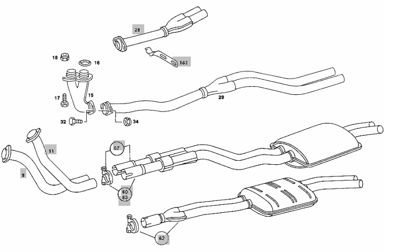

the 280SE had a wheel alignment done after I did all that work on the tie rods and is now at a muffler shop to have the rotten exhaust system fixed.
3,774
The 280SE moves from being a garage queen to a rolling restoration now.
Exhaust is fixed and it drives reasonably well once warmed up.
Next couple of things include fixing the drivers seat and replacing the thermostat so it can warm up faster.
