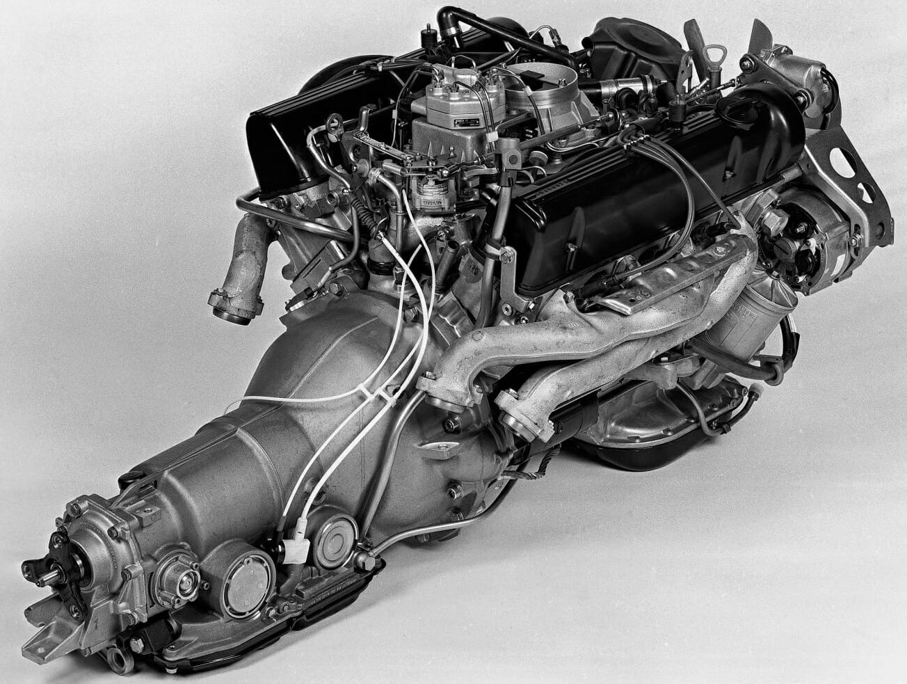

It is interesting that in the latter development of the W126, Benz were suddenly competing with the 300hp BMW V12 which was introduced in 1987. In response, they developed the 220kW M117 which included higher compression, knock sensors & the Tri Y exhaust manifolds. Interesting that the modifications did not extend to the intake area. Perhaps they achieved their objective within budget limitations & it was unnecessary to take things any further? Particularly when considering the substantially different M119 & W140/W129 were just around the corner.
6,016
It is also worth observing that the early M119 featured a substantially different air filter housing despite still using K Jet. And the later M119 used a different intake manifold similar to the much earlier D Jet
