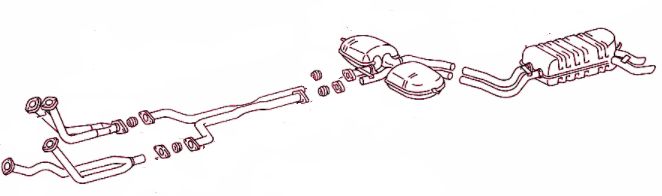

I’ve just been doing some calculations & if you believe one school of thought, exhaust primaries should be a minimum length for optimum flow. Of course space is the biggest issue here, but by my math (using optimum diameter pipe), the minimum primary lengths are as follows:
560: 538mm
6.9: 632mm
6,016
I can see why some tuners try to use equal length primaries, but they don’t seem to realise that tight bends will also restrict flow...
560: 538mm
6.9: 632mm
But what diameter pipe are you considering?
6,016
This was based on a minimum ID of 40.5mm (1.59”) for the 560. Minimum ID of 41.5mm (1.63”) for the 6.9.
6,016
I was speaking to a mate who races a 450SE & his mods have been recommended by a well known racing team in V8SC. They specified an OD of 1 7/8” (47.63mm) and a minimum primary length of no less than 28” (711.2mm)!! Of course that’s in an ideal world with no space limitations.... So based on a wall thickness of 2mm that leaves an ID of 43.63mm. Not far off my calculations which were minimum sizes not taking into consideration size availability....
6,016
BTW he also said you should run a twin 3” (76.2mm) OD exhaust which I think is far too big!! But then again his car does produce 440hp...
6,016
Interesting that his secondary ID is too small when compared to my calculations...
