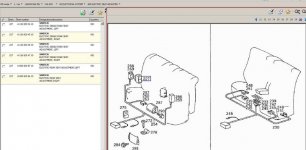

Looking at the EPC, it looks like there are a few different part numbers for the switches. Normally it tells you what has been superseded by another one.
The first two part numbers are NLA, but the second two are not. Since W126 parts are going NLA so rapidly, I may pick up a couple of these switches so I have them on hand if needed.
