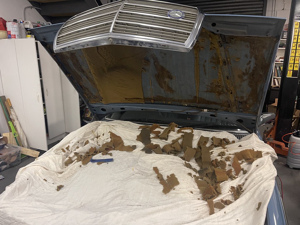

Next was the under bonnet insulation. I was already doing the 107 (will post some pictures of that soon) so did the 123 at the same time.
2024-05-18 20-33-28.jpeg2024-05-18 20-47-53.jpeg2024-05-18 21-22-37.jpeg2024-05-18 21-34-02.jpeg2024-05-18 21-41-25.jpeg2024-05-18 21-41-25.jpeg2024-05-18 21-57-00.jpeg
Under bonnet insulation king!

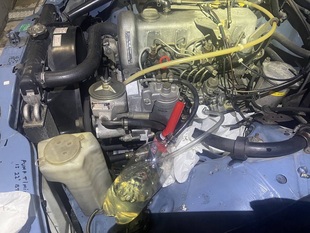

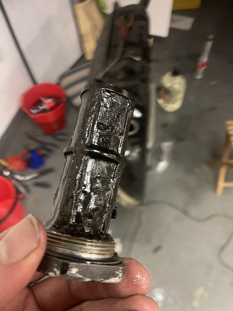

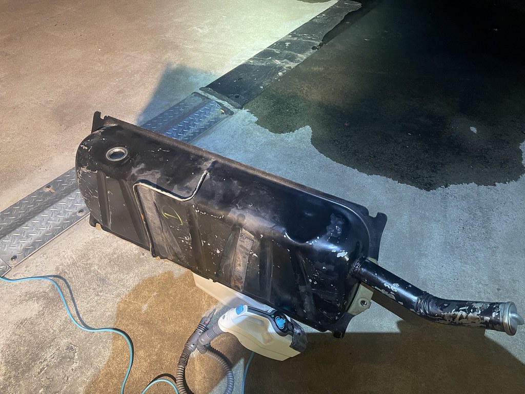

240D is going well, but like a lot of low mileage diesels it has sticking front brakes, and an algae build up in the fuel tank. All solvable problems.
3,855
Read your story so far on your other site- what fun! (Perhaps not). In my opinion your 240D is a very special car so the efforts will not be wasted.
Yes, these are all issues with a low mileage car that sat around a bit. But given the condition of the car, I don't mind doing these things.
