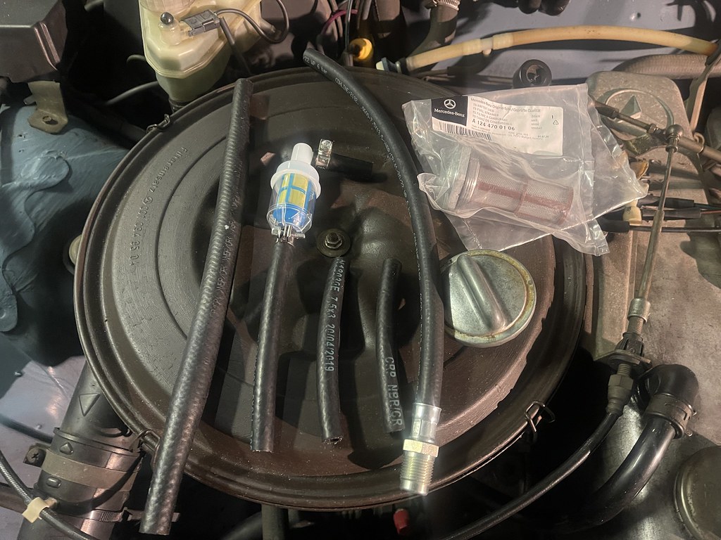

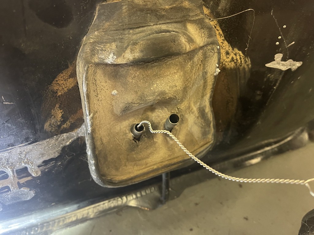

My diesel is now back up and running. It is sporting a fuel tank from a 280E.

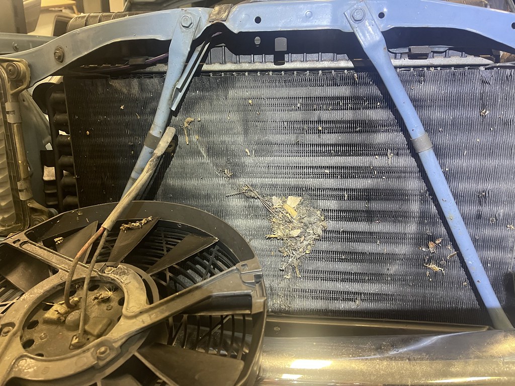

Turns out the aux fan is dead. The relay clicks, but the fan does not come on even when the relay is bypassed. So new fan on order.

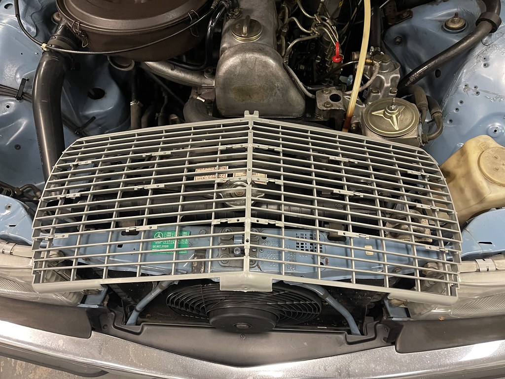

Recently I replaced the plastic grille insert:
I also replaced the aux fan:

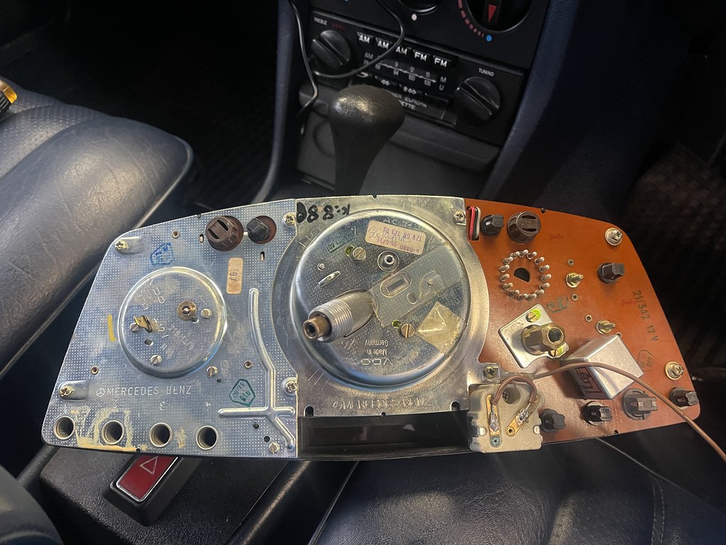

Bad grounds in the cluster are also a known W123 issue, so did some work on that too:
