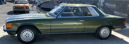

I really like this SLC
Its a private import, but not sure where from. It looks very well looked after, so perhaps Japan? If that is the case, good for condition, not so good for the very detuned motors they got there. Other countries will have the high compression motor, or the mid range one like we got.
