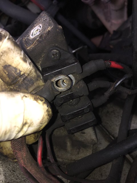

ok so update from todays tinkering...
I pulled the battery and all relative hardware, I could not believe the amount of dirt grim and caked in oil on the wiring connections and earth strap from the alternator. ive cleaned EVERYTHING and sanded all nuts, bolts, screws, lugs and connections.
the regulator was a mess, caked in grime and as everyone suggested was worn substantially. ive put everything back check all connections, even refitted the regulator and what do you know, it fired up no problem. I tested the voltage of the batter before I connected, it read 12.3v and connected with the engine on load it was reading 13.8v.
some pics below to show the state of the connections and regulator:
terminal block under battery tray:
W116 by Neil Irvine, on Flickr

i really want to change the regulator asap as from the pics its stuffed, i dont trust how long its got left. problem is the suppliers near me only stock bosch regulators and they need the part number.
can some one please give the part number i need??? its for a '74 280se...
