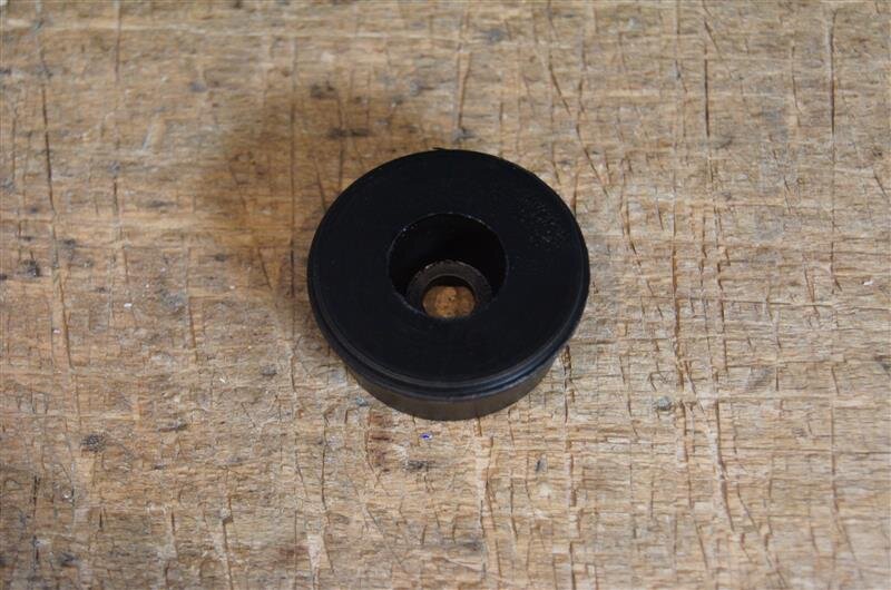

Rear strut repair:
Parts sourcing:
Rubber mounts from mbclassics:
Ball joint from VPS Vargalant in Slovenia:
The rubber boot was bought from a local Mercedes dealer and was about 90 euros
The rear seat has to be removed to access the upper bolt.
The strut after removal:
New vs old rubber mount:
Old vs new ball joint:
After disassembly:
Some zinc paint:
Installing the new ball joint. Not much room for the tools:
Finished and ready to be installed:
