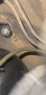

Hi all, I have a 1979 6.9, the hardline that runs from the engine to the rear accumulator is damaged and leaking, can these be purchased or can you replace with steel brake line?

Hi & welcome! You’d have to try to identify the part number & start searching. One from a wreck might also be an option unless accessibility is difficult.
I’d like to know what coating was applied to these. I thought anodising was only for alloy? It doesn’t look like zinc & peels off fairly easily. Could it just be green coloured paint or powder coat??

Having been absent from TK for considerable time due to significant private commitments, I felt that now I should put pen to paper, or fingers to keyboard if you like, to feature some very important procedures in testing the Hydraulic System on our 6.9s, and the idiosyncracies that one may experience when the suspension is not doing what it should. Firstly, I'll reply to CJ in Sydney. Don't know who he is (hope is name is not JOE), but I am trying to get around in identifying his problem in spite of the picture on hand. Tricky situation, although somewhat not unusual. I haven't done it, but it would be quite easy to cross thread the nipple fitting if one is hamfisted. The problem usually rests with the Operator. An alternative fitting would definitely be available from a Brake outlet, but you will need to take the nipple and obtain likewise. I haven't been under my car for a long time, but hopefully the damaged pipe may run to a junction that would feature other lines as well. I f there is, your job should be fairly easy.
To answer our friend and esteemed contributor Oversize, the steel lines would have to be powdercoated in that nice green colour. Freshly painted, they look impressive and very professional ! Regards Styria
