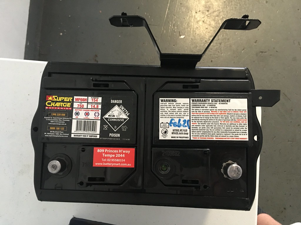

Yes I do have the 60 and would like to find the right size for the 88 that will fit. all the ones I tried in the store didn't work with the battery hold down, had recessed terminals or were too tall.
9,485
Bryce, the 88 unit will not fit as the cradle that is part of the inner chassis member is too small. You will need to find a 66 (?) model with the recessed terminals. I believe if you fitted a unit with exposed terminals, they could easily touch the underside of the bonnet.
I have a spare 88 unit on hand that you could try, but I am quite certain that it will not fit. I will send you a picture of that battery. Regards Styria

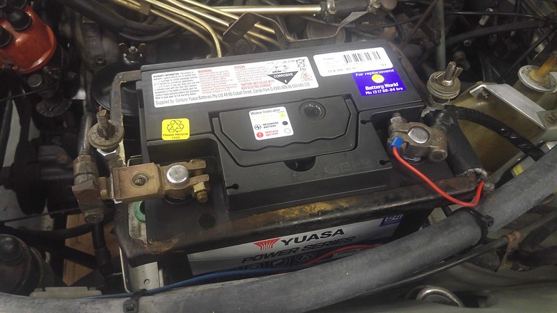

I had more of a look. You're right, a DIN88 will not fit. Hoever, the battery I have now is a DIN53ML which is also too small
You can see its too short, so I've had to pack the bracket with washers and nuts. Its also not long enough.
Doing some quick measurements, the ideal battery is roughly 280 long, 170 wide, and 180 tall.
the battery I have in place is about 240 long, and has recessed terminals which is not ideal.
I think I need something close to a DIN65, but not quite.
