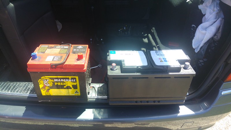

I had to change the battery in the E350 this weekend. The car is almost 10 years old (07 model) and the battery was still the original one. Not bad.
Check out the size difference between the E350 battery and the one I took out of the old Lexus GS300 last time I had to change a battery in there:
