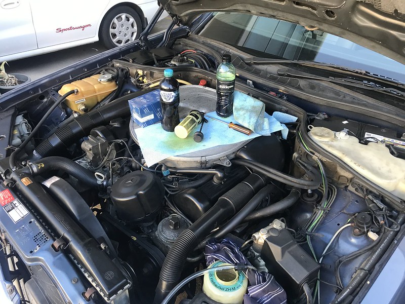

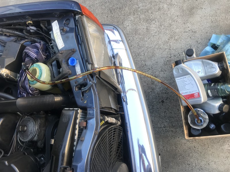

I've been meaning to flush the SLS since I got the car. I did it today, along with the 300SE.
The fluid was worse than it looked, once you get it into a clear bottle.

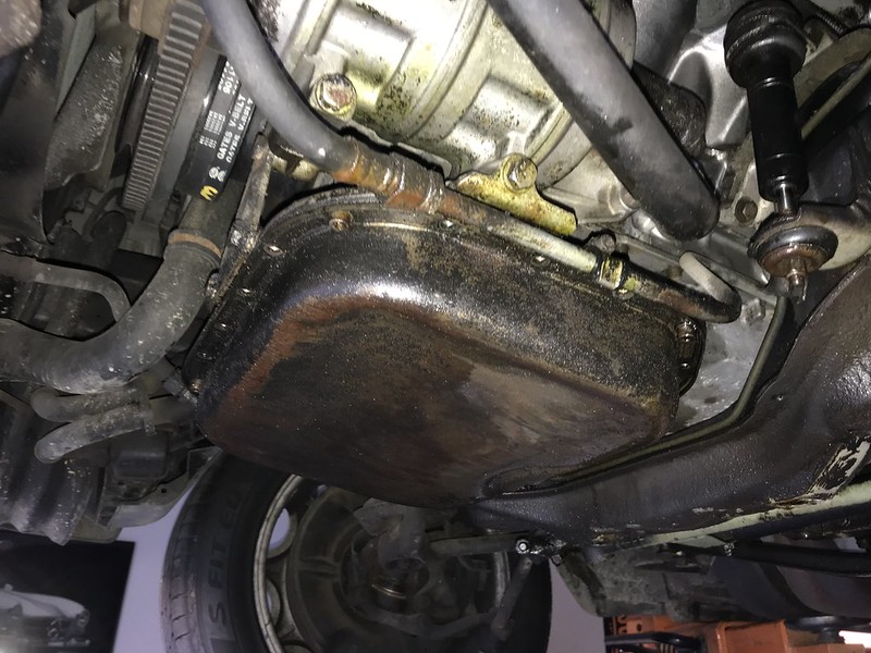

Today my job is to replace the dented lower pan...

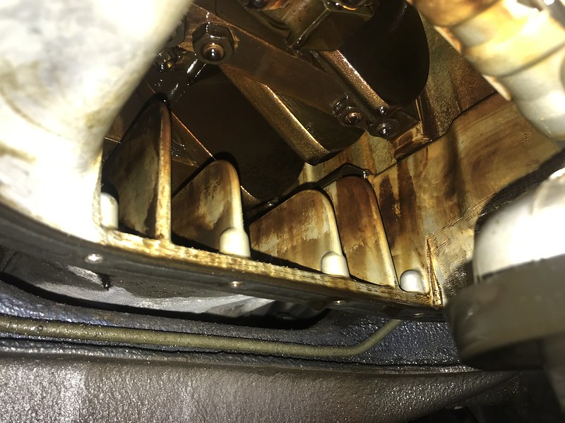

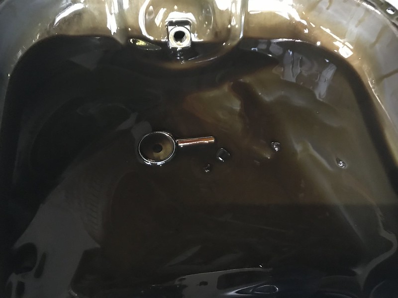

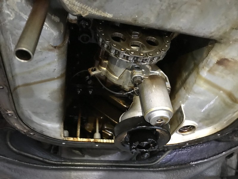

I took off the lower pan, and as expected I found a piece of broken guide in there. One of the guides was broken when I had the chain done a few months back.

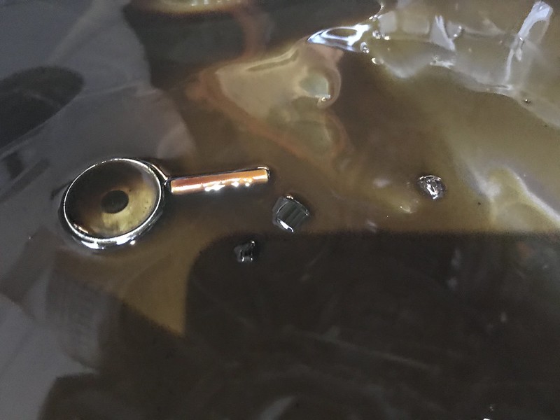

What I didn't expect was to find a large lipped washer.
Does anyone know what it is?
There was no gasket on the pan, just some black sealer that wasn't sealing all that well.
There was also some small pieces of broken black plastic.
From what I can see, no damage from the dented pan?
Engine looks suspiciously clean. I wonder if it has been out? Engine number matches data card.

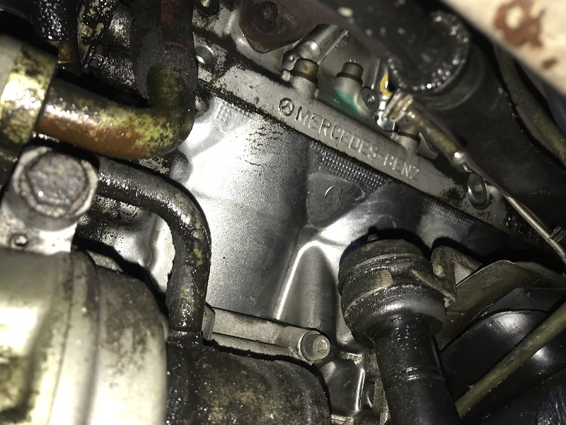

Dented pan before removal:
3,918

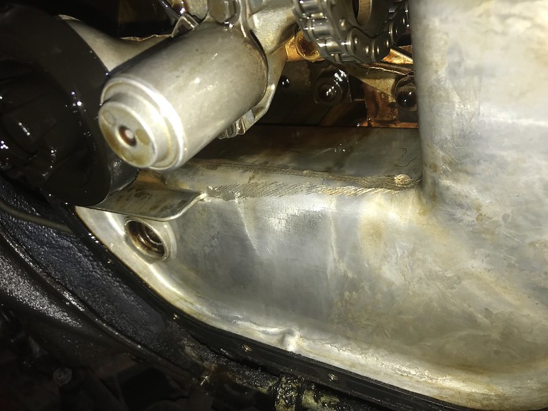

as I started cleaning the surfaces, I also notice there has been scoring on the upper pan, you can see to the right hand side of the oil pump as you're standing in front of the car and rear of oil pump.
I wonder how that got there?
