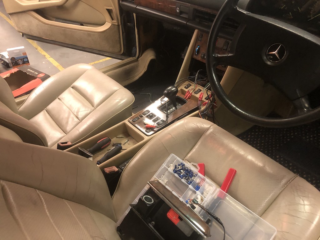

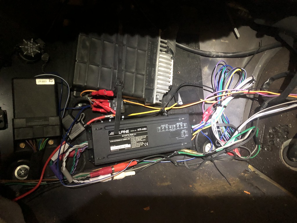

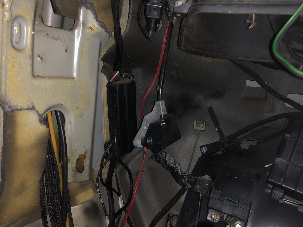

The work to install the becker has started. But first I wanted to find the X30 power block that is referenced in the manuals, but only its position in the LHD cars is noted:
From there, I need to remove the rats nest of old wires that supported the now defunct cobra car alarm.

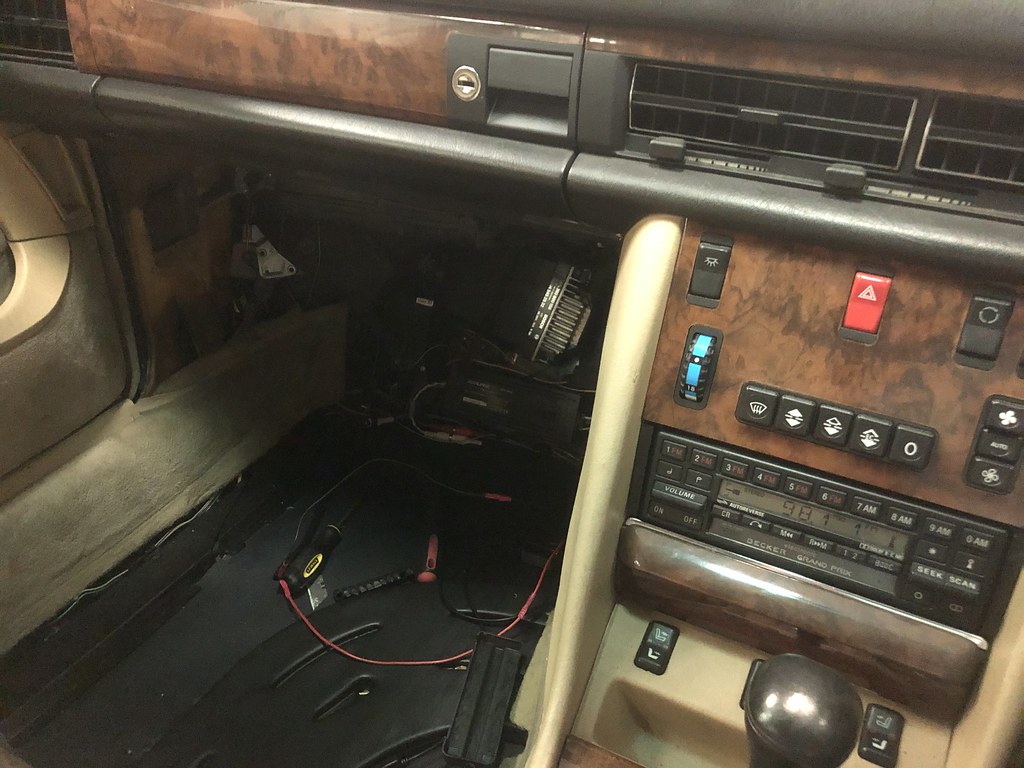

Part two done - the system works and I am pretty happy with it. Just needs some fine tuning and to tidy up the install.

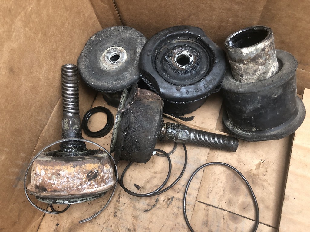

Got the 560SEC back after a rebuilt steering box (was leaking) and the guide rod mount bushes. They actually looked alright, but the oil leak had been covering one of them and so It was recommended they were changed. I'm glad we did, as they had clearly been in since the car's time in the UK and were well past their use by date.
