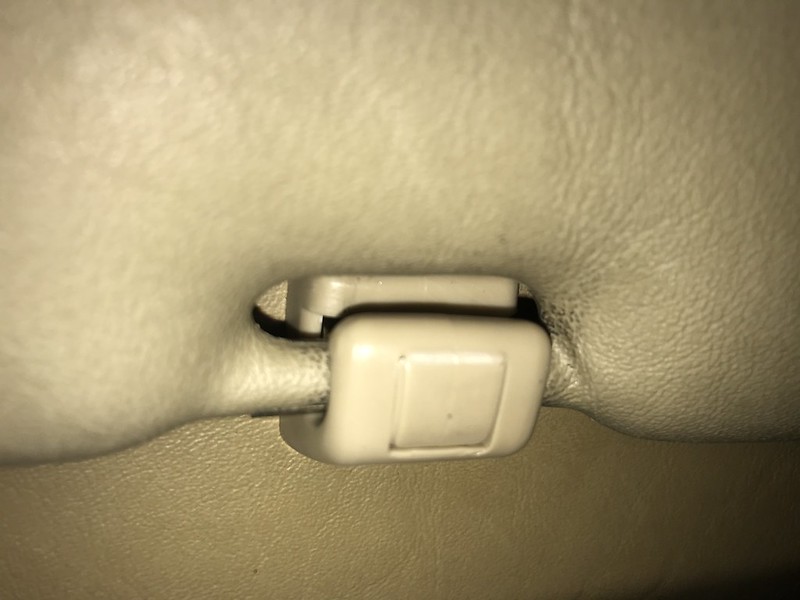

Had a few minutes this morning so fixed something that was annoying me, a broken visor clip.
