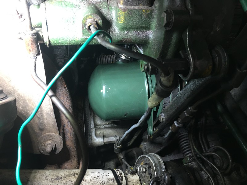

In 2021 I had to put on a rebuilt hydraulic pump. It was still pumping ok, but had started to leak. This was putting oil on the brake disc, which is not ideal for stopping the car. The DS has inboard front disc brakes.
Swapping out the DS hydraulic pump on my 1970 DS21 BVH. Also tracing an engine rattle to the air cleaner bracket.

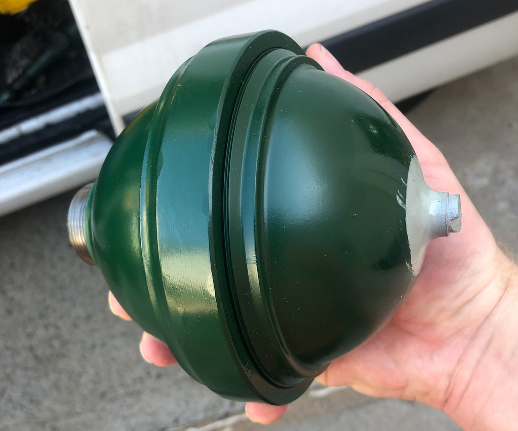

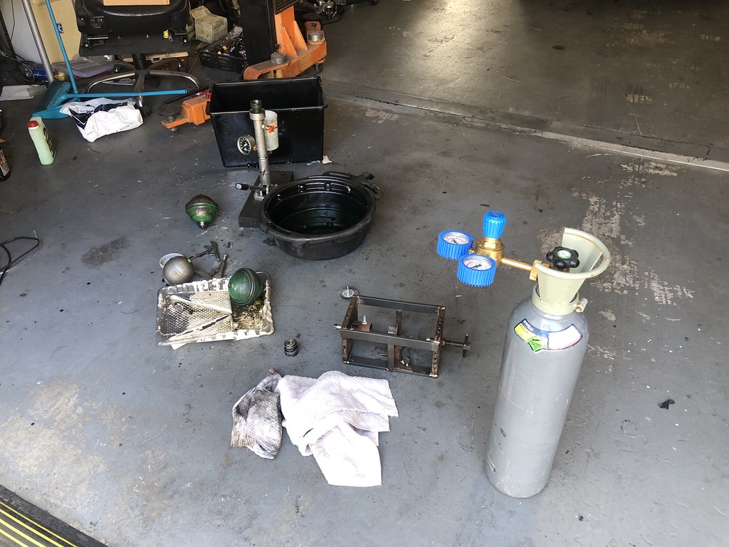

The ride had become pretty bad, so had the front sphere's regassed, and the rears rebuilt. Unlike the Mercedes with the similar system, the Citroen spheres are rebuildable - at least to about 1974. The CX and the very last of the D models went to disposable spheres.
Citroen DS sphere regassing and pressure check. My 1970 Citroen DS 21 was not riding well, so it was time to check the sphere pressures.

Installing the rebuilt rear spheres on my 1970 Citroen DS21. They have transformed the ride to where it was before.

It is now back to riding like a DS should.
