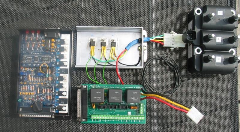

Ive had just about enough of my kjet. The thing is a headache and parts are hard to come by.
Thinking of a conversion to EFI
There is a long write up (a few years old now) on Benz World on a Megasquirt conversion
OR somthing like this
