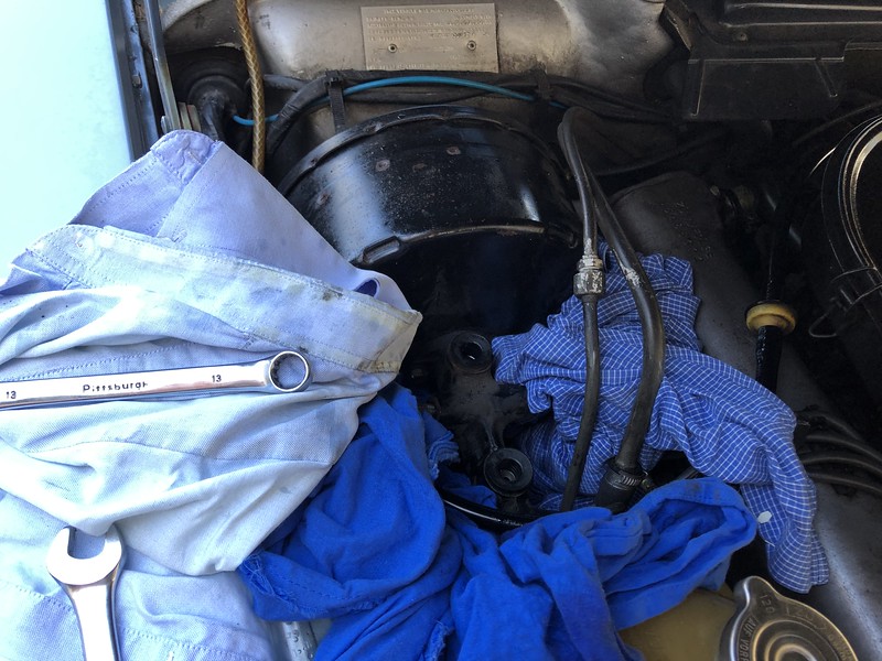

I also replaced the master, even though the fluid had been flushed about 18 months ago and looked good colour, once I removed the resevoir there was quite a lot of horrible black fluid in there somewhere.
the only real problem is I am having a devil of a time removing the rear hoses. Perhaps the heat has affected them but I can't seem to get them to budge at all, even with penetrating oil. I will need to get a new piece of hard line on one side, and so I didn't damage the other side hard line I just soaked it in penetrant to see it will be easier when I get the calipers.
I don't have a brake line flaring and bending tool, so I will probably see if I can just buy the one small section I need.

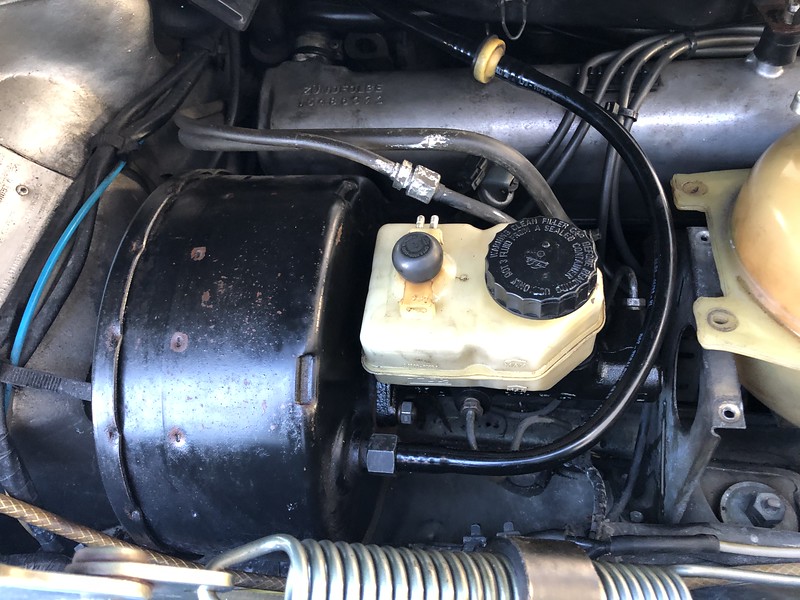

Brakes work really well now - I have a new master, four new hoses, new calipers and rotors on the rear and some new lines on the rear.

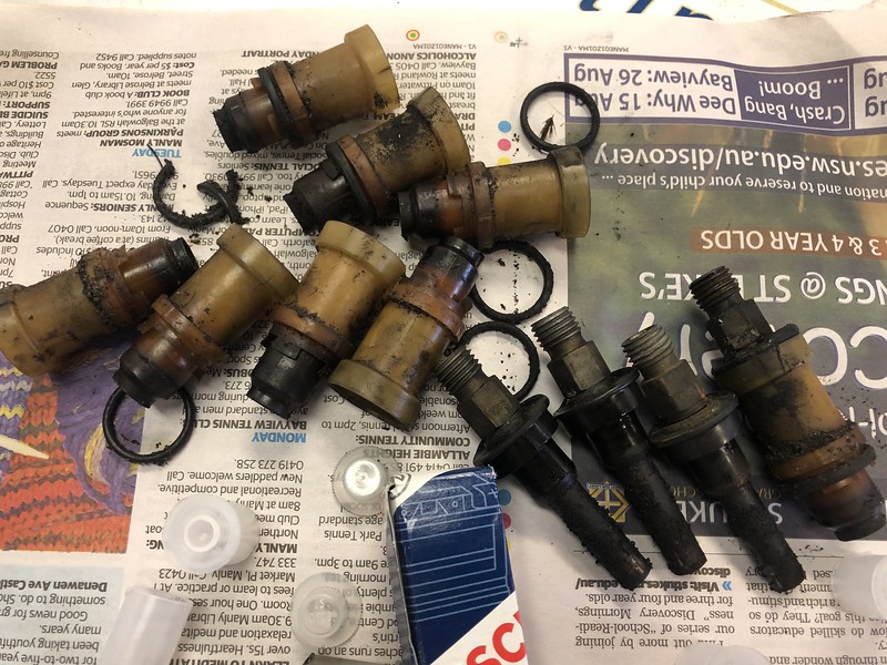

I didn't start the SLC for about 2.5 months due to COVID and since I woke it up again its been running quite poorly.
When started up it feels like it is not running on all cylinders until it warms up a bit, and then there feels like there is a miss under load.

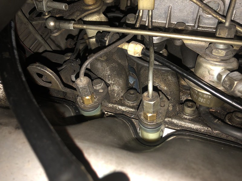

I've been thinking about changing the injectors for a few years as the car hasn't run great when first started up but gets better - making me think one or more injectors is not atomizing the fuel but as the car warms up it compensates. CIS injectors are still not that expensive, so better to swap them while they are still available. I've owned the car 17 years and never changed them. I have the injectors, seals and the sleeve things on order.
I will change the injectors and plugs, and check the suppressors. If that doesn't help, then I will take it to my mechanic but at least those first two things are improvements that probably should be done anyway and may help.

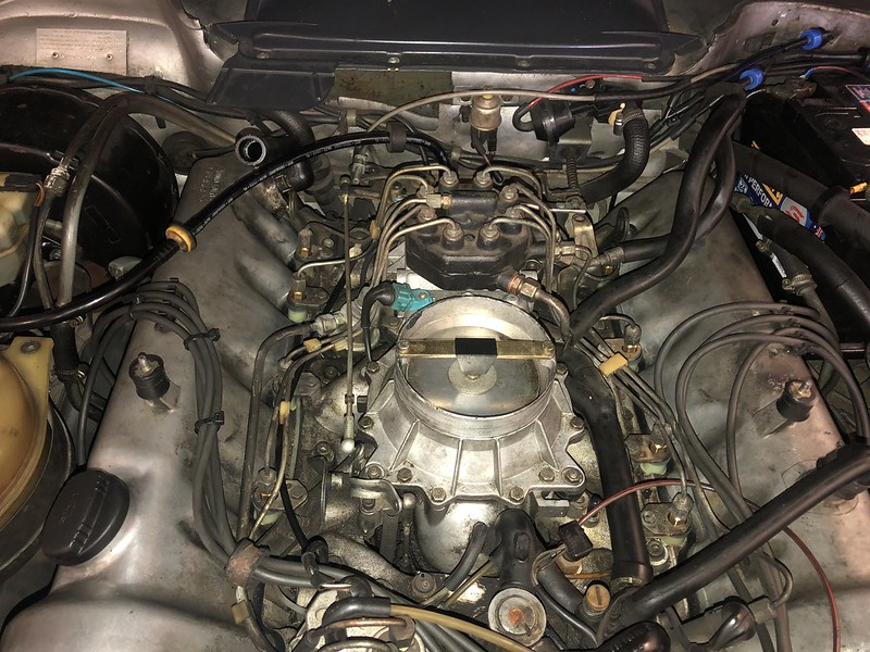

I took the 450SLC on an extended 250km drive the other night that included some motorway sections, fast back roads and winding roads.
The new injectors have made a big difference on how the car performs.

I got them from AutohausAZ, about USD$20 each, and then a few bux each for the sleves and seals.
While I was at it I changed the plugs too. I had a set on the shelf.
