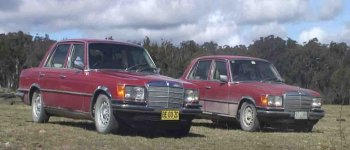

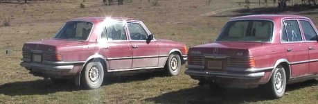

heres some piccies of the two deviates..."2' is the car just auctioned on ebay..needs about a week of body work and rust removal...and then a complete respray...should be ready in about 90 days at my speed..but it drives very nicely and is mechanically sound..the car on the left is "1' and is a beautiful car from Queensland..almost consourse but not quite...that spent nearly 20 years locked up in a garage after its owner died..we live on a farm..so mud is a constant unfortunately

Well, you know Zixtus, you have already been accepted as a most valuable member of the topklasse fraternity - not one, but two red cars, constitute a passport to star status on the site - just ask Michel, and he will confirm it.
Rust Repairs, repaint - are you going to do it yourself ? There are a couple of bods on the site that would steer you in the right direction. I guess it is a little unfortunate that you don't live in a dust free enviroment as it does take extra time to keep cars in pristine condition.
With the upholstery - do you have leather, or velour and is the normally accepted beige/cream/parchment ? Anyway I guess, we shall see you sometime in the future. Regards Styria
