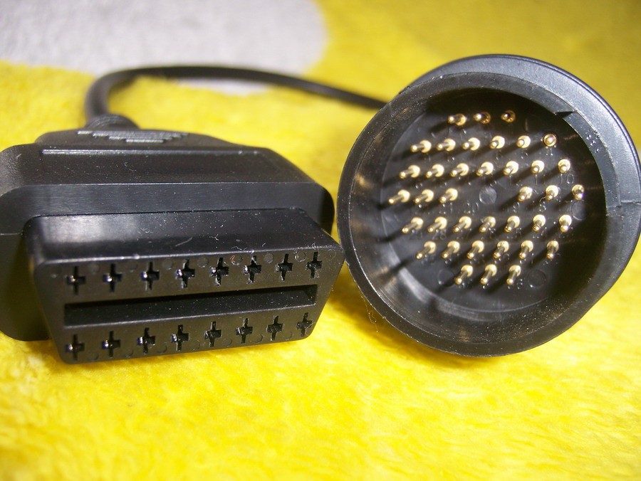

Whilst I prefer to work on cars with Chrome bumpers I do have some knowledge on these and are reasonably sure that MB never used OBD1. Instead they used there own 38 pin connector which had a pin for each function. See this picture that i have pinched off ebay..
http://img.auctiva.com/imgdata/1/3/1/2/ ... 5526_o.jpg
Big round bit is the MB specific 38 pin connector and the OBD2 is the more rectangular looking one... The 38 pin connector was designed for the MB in house designed HHT (Hand Held Tester), unlike the later OBD2 systems where any generic tester will plug in...
The early W140 used the 38 pin connector and the later cars the OBD2, where the change was I are not entirly sure, somewhere around 95/96 I would presume.

Thanks a million guys OBD2 it is with MB connector the dealer here has been kind enough to acquire me the connector and the program I sourced from ebay so finally I can talk to the big beast.
