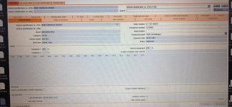

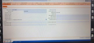

Build date & location finally confirmed, along with some interesting details on options ordered. Strange they didn’t go for rear seat heaters. It would’ve been great to have a rear blind, but probably not much use in GB....
3,913
Good to get this detail, my car was made 5 months later also for UK market. - btw, this site helps translate the codes for you:
