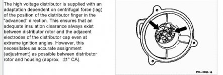

Mechanical advance when I think it should be electronic & cold start injector mounted upside down (now fixed)!!
This is the electronic dizzy on one of my other cars. Would a 420 dizzy fit a 560??
My current thoughts are someone’s fitted an Aussie dizzy as something went wrong with the electronic advance... :eek:
I think it would physically fit but the part number is almost certainly different.
I don't have the tech data book for this set of years, but looking at the tech data book for 1980, each different engine has a different distributor number.
I don't know how much difference there would be in reality.
