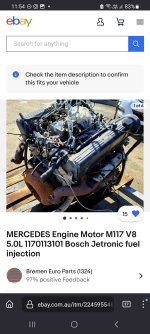

Staring down the barrel of having to pull out the engine and transmission to replace the ring gear anyway, and wondering how likely it is that there's nothing internally wrong with the m116...
eBay is tormenting me with plausible-sounding bad ideas...
Change my mind?
I have nowhere to store it, much as I'd love to pull apart and rebuild an engine and if-so-then-why-not-go-all-out etc. And yes I do realise I'd need a w126 gearbox too (and a solution for speedo drive). At which point an efi Windsor and T5 start to sound like nearly sensible alternatives...
It's late... bad ideas are multiplying...
and 111/116/124/126
3,456
760
if you're going to do the engine, put in a Mercedes engine like this. It will bolt right up and the fuel injection is the same. All the K-jet engines will - 450, 380, 500. The KE engines 420, 560 are more work.
Putting the ford in will just be headache after headache and once done, the car will have no value as Mercedes buyers are not interested in engine swaps. So you would have to love it, or not care.

...once done, the car will have no value...
I think that was true the moment I pulled the Aeros off it :)
In all seriousness I'd love to go 5.0 (that one's either one of the ECE ones they made after the 5.6 [if I read your blog right, Bryce?] or someone has swapped the "amg style" tri Y headers onto it, so... sweaty palms etc...) because I know I'd sink heaps of time and money into the 3.5 as soon as it's out anyway ("might as well"... *complete rebuild*)...
But I just don't have the facilities :( One engine next to a stranded car I can fit temporarily in my garage. But not 2/ one long term etc.
Like I say, I bought the wrong house...
See now that im not only looking at engine out anyway, but $6-800 of new ignition and $300 of injection service plus my time, valve covers off and probably timing chain to factor in before I even get it into the garage to do it, the reason to consider a Ford swap is not even "easy power" or cost vs another Benz engine and transmission which might need fiddling to adapt to the cars cluster...
It's *just* about parts availability. I literally couldn't find a rotor button online last night. The closest was a 4.5 one with the lower rev limit, and the believably genuine one of those was $400 shipped... Lead sets to suit the later dizzy cap are similar... RHD starters are unobtanium. Literally the only option I could figure out was buying a used core from a UK wrecker, a nos pinion clutch from Turkey, and doing what I did to partially refurbish one yourself (or pay an autosparkie to). $500 in parts plus labour for a used starter and the hassle involved is getting on for silly with a car that isn't some exotic or collectable. Sbf or sbc parts, in contrast, will be plentiful for years.
At the end of the day I'd rather drive my car than have a garage ornament full of 3 point stars, if that's the choice it comes down to. So of course I see your point, but resale value doesn't make for a super strong argument when the capital outlay to maintain it might outweigh it and my time expenditure might render it moot...
Understand, the main point I was trying to make is while the ford engine is cheap, adapting it is not. A few have tried and had all sorts of issues with the steering system fouling, oil pans not clearing the cross member, the diff ratios being all wrong etc. So its not just a drop in if you want a good drivable car.
Point well taken. All that packaging trouble is the sort of thing I'd probably have gotten fed up with before making any costly mistakes *if* I'd started working through all the implications of such a swap before recklessly ebaying under the influence. But fortunately I'm naturally inclined to stick to m11X power in any case. And whether out of trepidation or conservatism even quite partial to just fixing whatever is wrong with the m116. I guess whatever gets it drivable and not living on chassis stands as soon as possible will ultimately win. Seems a long way off but.
I guess the idea of a pain barrier, once overcome, is just sometimes more appealing than the dread of ongoing herculean quests every time something breaks. I mean, even the plug leads are a pain 🤣
