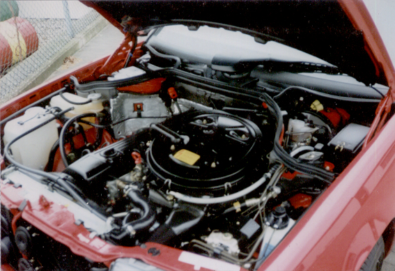

The stickers must fall off from the engine heat or get pulled off,
for anyone interested this is the correct placement for the aircleaner sticker
