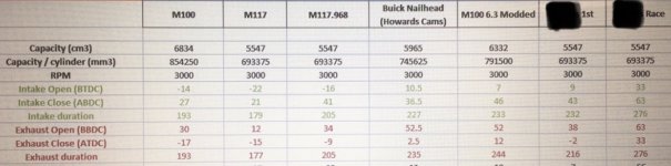

It seems to me there's a huge amount of R&D involved with cams and no hard and fast rules apply. Every engine is different which makes cam selection very difficult. Even worse, it seems there's not much info on the AMG cams to use them as a benchmark. Perhaps the only true way to do it is pull one out and have it checked? The other thing is a lot has changed since the 80s when AMG was definitely still experimenting. WE now know some of the limitations of KE Jet, the standard intakes and exhausts. I'm taking a punt that a better grind can be found (particularly for EFI)....

Seems the Benz cams are rather retarded compared to others. However Benz list specs at 2mm lift instead of the usual 0.050”. Not even the metric equivalent! Of course they have to be different!!

I’m evaluating all V8 cams but yes it’s interesting that the Euro M117.968 cams are still rather mild
