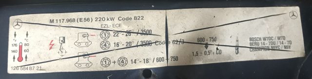

Interesting the timing difference ECE vs RUF given the same output, here is my car's sticker.

Oh forgot to mention I’m not convinced it has the original timing sticker....
