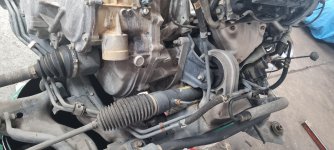

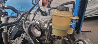

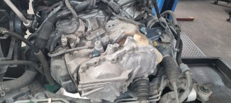

Okay, to start off with, some well overdue pics. The first I saw of the work involved, is the unit sitting on the 20 gallon drum - Caltex of course.
N.B. Sugar, it's Castrol.

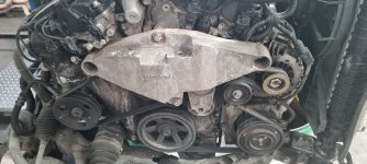

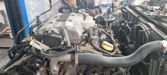

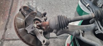

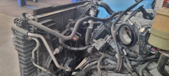

I just don't know how to continue my text without starting a new "reply". When one considers that Captivas are saddled with some uncomplimentary terms for a number of problem issues, the set up is illustrated probably owes very little, if nothing, to the more "glamorous SUVs on the market. Let's face it, this engine is just a simple Holden 3.2 litre V6 shipped the South Korea by Holden. On to that of course, Daewoo would add a five speed Aisin Auto transmission. This engine is now up to 222,333 kilometers, with not a sign of wear, still whisper quiet and uses no oil between changes - I don't think I could ask for better or, indeed, more reliable. On that note, more remarks later. More pics. in the meantime.20210929_142216.jpg20220912_101642.jpg20220912_101657.jpg20220912_101708.jpg20220912_101726.jpg

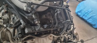

The third picture shows one of the engine mounts. The reason for the cost of $570.00 for the mounts ? As can be seen, they are substantial in size and are bought as complete units sitting in huge alloy cases - you don't just replace the rubber mount, but you replace the complete housing - and there were three of those mounts. One issue that hastened my desire and need to get this work done was a very noisy water pump. After the last service, in fact about five days after, I noticed this grumbling noise which I almost immediately put down to a noisy bearing in the water pump housing. The mechanic ventured a noisy drive/water pump belt, but I questioned his diagnosis and putting up the car on his hoist revealed the all to clearly evident slight coolant leak - I knew this work just needed doing urgently. The pump is shown in the sixth picture. Regards Styria
N.B. Please forgive me for any duplications. 20220912_101657.jpg20220912_101708.jpg20220912_101726.jpg20220912_101733.jpg20220912_101743.jpg20220912_101812.jpg20220912_101812.jpg20220912_101816.jpg
