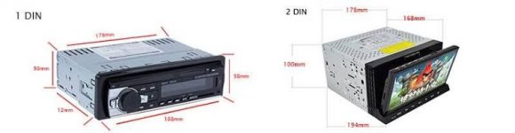

I received and fitted my new radio today FM usb/Sd/MP3/BLUETOOTH. 4X 60 WATT CHANNELS. HANDS FREE. What more do you need!. I know some will frown on this purchase but I am very happy with it. Relating this to my cradel questions. This came with a cradel. I could then see what my problem was. Some one in the cars dim and chequered past with hands the size of a pair of large dinner plates must have fitted a wider radio and butchered the radio cut out ripping of the side lips of the opening. This is why I could not understand what kept the radio in there . There was no way of mounting a cradel in there!
I overcame this act of pure butchery by making up two wooden blocks and managed to screw one in on each side. I was able to do this because the transmissin hump is timber lined. I was then able to put scews into the wood blocks to secure the cradel. I cant believe I was able to buy this for $22.11 cents this included delivery by courier. I only ordered this on Tuesday and now two days later all fitted. To me it sounds great I am 72 years old and I might have lost some top end frequency response. Hey! Who cares.

Top job Jim.
The reason why it was butchered as radios back in the 70’s were slightly smaller than the radios we use today that are all of a common size or standard world wide.
We know it as a DIN
This wasn’t a standard until the mid eighties.
Some cars now have double DIN audio/multimedia systems with large screens.
Earlier radios were slightly narrower, then the front was covered by a larger trim or plate and generally fitted from behind, thus the sides of your slot being removed, they would have fitted a later single DIN audio unit for sure.
