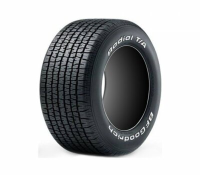

It's uncanny that I have just come across this thread in view of the fact that just yesterday I posted details of chrome Bundts fitted to Gleaming Beauty as part of a recommissioning process that I am undertaking. I can in all honesty say that the ride, even with the Super Heavy Speedys, is totally acceptable - in fact probably a little bit like an Air Suspension 6.3, but still comfortable and certainly surefooted. It is a long time since GB had been fitted with the conventional Alloys, but I did not think that there was anything particularly remarkable as far as ride comfort and handling were concerned. It will indeed be interesting how GB will react to the Balloon proportioned 215.70.14 B.F.Goodrich Supertown (s) manufactured in...wait for it, Columbia. They are very impressive looking with a fairly coarse thread. Regards Styria
N.B. I have just spotted these very same tyres, but in 15", advertised on ebay by Tempe Tyres.
6,016
I wouldn’t imagine those tyres would be great on wet roads. But it’s good that size is available. Of note is if the profile is the same the rolling diameter will be different. I’ll have to check my references to see if the 15s are still within the limit that won’t affect the speedo.

Mark, how uncanny is your observation in regards to handling properties with those B.F.s fitted to Gleaming Beauty. I never bothered to check the date of manufacture as there is plenty of good thread on the tyres and they were, as luck would have it, the correct 6.9 size tyres. During the last three days, I have driven GB on roads somewhat wet/half dry from rain Sydney has experienced over the last few days. At one stage, take off from lights and going uphill resulted in wheelspin on a VERY light throttle, and accelerating out from a Round About again made the tyres chirp again on moderate throttle opening. I have adjusted my driving to compensate for the lack of grip from the tyres on a moist road surface. Regards Styria
3,918
I would strongly encourage you to check the age. Tyres over 8 years old get hard and lose their grip - they become seriously unsafe and modern synthetic rubber compounds are far worse with this. Having experienced a few cars with old tyres it’s my view that annual roadworthy checks should inspect this and fail cars with aged tyres. Far more unsafe than some tread wear.
A lot of garages check tyres for age and fail cars if they are 7 years or older.

My friends, I hear and read what you are saying. Certainly no arguments from me. I will just see what action I will take in due course. Regards Styria
