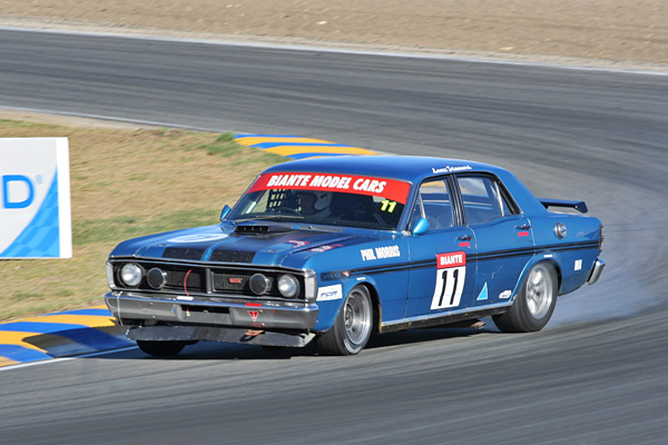

Ian that boot spoiler looks like it was made for the 116.
I guess you will do some trial and error, I wonder what affect, if any the spoiler would have raised up a bit? with some spacers of some sort under it?
116's and fords of the period are fairly similar shaped, I've said before that the shaker scoop would look at home on the bonnet.
Bonnet scoops ay.... :rolleyes:
