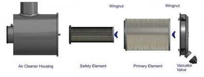

2,643
Our Australian spec trucks run dual elements in a single housing like this.
Sometimes in remote areas where it is extremely dusty, (especially our super fine red bull dust) they will run 2 of these in series.
Modern truck turbos are under so much pressure the slightest trace of dust can be catastrophic.
