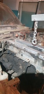

Hello everyone! I am at the beginning of a long journey to return automatic transmission to my car. Currently, a 5-speed manual transmission is installed. But! Initially, from the factory, there was an automatic with steering column controls. To replace it, I managed to find a complete car that was disassembled. In exactly the same configuration as my car,engine M110.922,transmission 722.100

However, I will continue. I received the motor with the box in an unconnected form. And completely everything that is necessary for installation. I will list: automatic transmission mounting brackets, driveshaft assembly,brake pedal,steering column with shift lever,all wiring from the car,instrument cluster with gearshift indicator. The automatic transmission had to be washed for quite a long time from a thick layer of oil dirt, after which it was removed from the engine. When I unscrewed the vacuum line from the modulator, oil started oozing out of the connection. Is this not normal?
